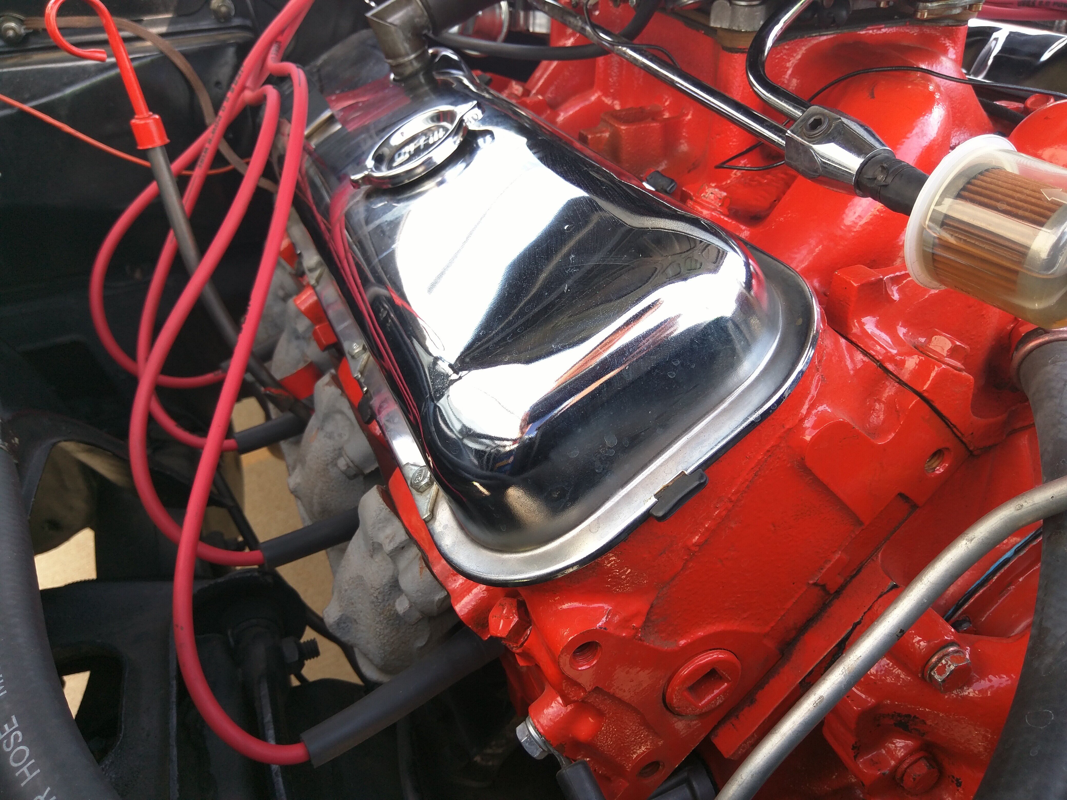

I have a friend who is flying out to Oklahoma next week to look at a car for sale. It is a '67 Camaro SS big block 4-speed convertible. It has a '69 396 in it, and he knows it is NOT numbers matching. His concern is... how does he tell if the car ORIGINALLY was a big block car to begin with from the factory? I am trying to get the VIN and maybe a pic of the cowl tag. But is there a list of things he can look at straight away to distinguish?... Danny

Danny, it's a 67 so the trim tag should give him info plus there are numerous threads concerning similar.

Only 1138 L78 Camaros in 67 and 4003 L35 Camaros in 67.

 I have two 67 L35's.....one from LOS (04B, TH400) and one from NOR (05B, 4 speed) to use a reference.

Seems to have the correct big block fuel line.  Which is a good sign.
