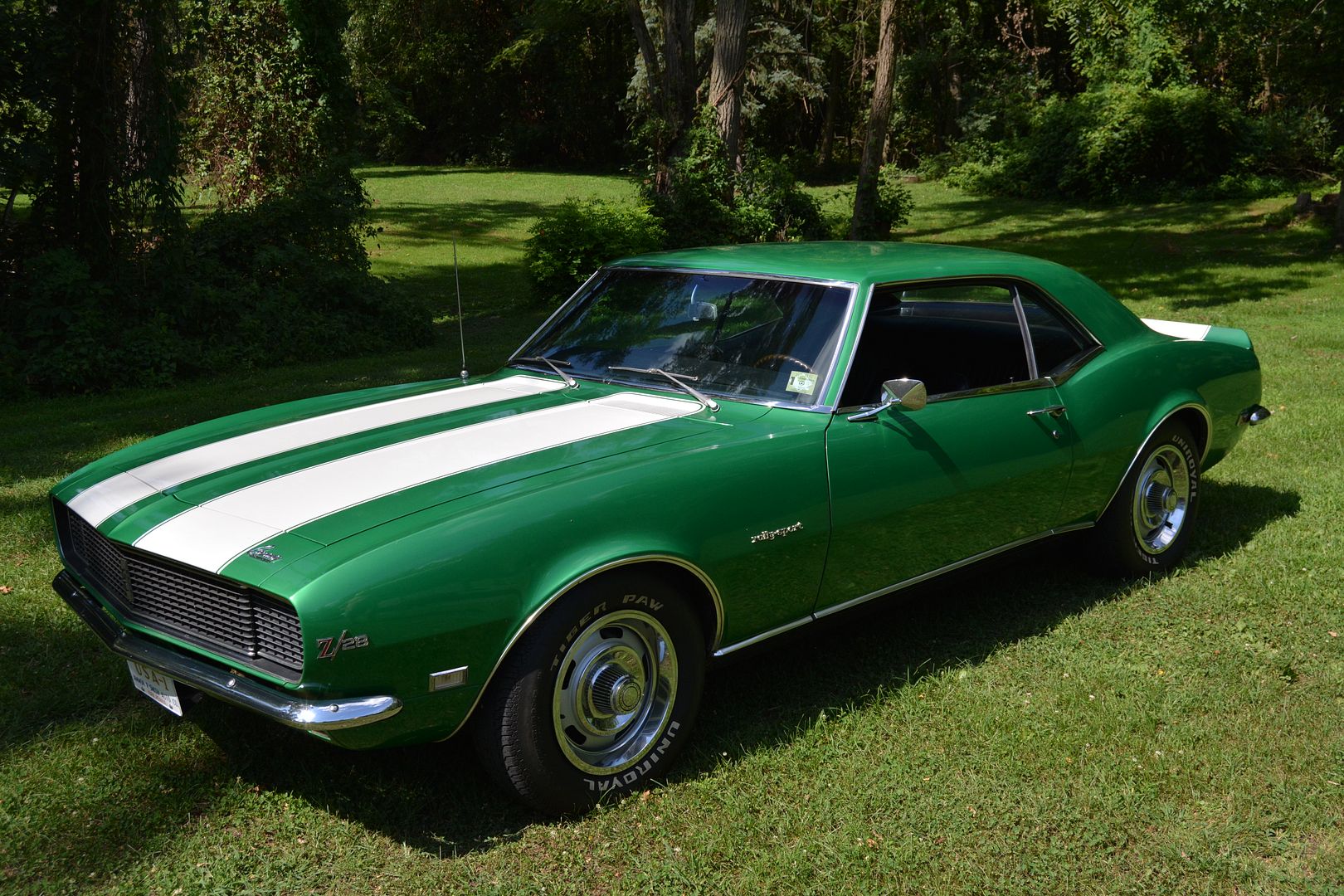

Re: 1968 non-RS wheel well moldings
« Reply #19 on: December 08, 2017, 07:34:46 PM »
Some NON RS cars have the short version ( look at Darrel Cook's Rally Green L78 in the original cars section).
Allen
Allen look at the thread again.  He did not originally order the car with the Z21 package.
Also you can not add Rinsor's 68 to the list either as it too was a non Z21 option car but had the wheel well molding added after.
Dave's 68 Z with Z21 option.
Skips RS Z
As for the rest of the conversation..  I'm staying out of it.

Holy buckets Darrell, that is a huge pic!
Not me.  I just copied and pasted.
Allen, I do not know of anything on his car that isnt original.  That was just my observation.  Not bad mouthing his car as its a better specimen on originality than anything I have just noticed the well moldings were for an RS.  Right or wrong its still an amazing car.
And thank you for the comment.  I'm kinda partial to the car.   :)

Yea, blame me Darrell as I'm the one who posted Skip's pic's. :) It was not that big when I posted it. LOL I think the system (CRG) automatically downsized it when loaded so I guess it is my fault for now until photobucket cancels 3rd party when my grandfathering is lost.
