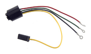

Yes there are OEM replacements and the variable unit. I posted links to variable and one to Matt's Classic Bowties, but the OEM module is available everywhere and most are made by Lectric Limited or Classic Headquarters. The OEM's run in the 50-60 buck range most of the time. You would wire the red tot he pink connection, green to the sender lug, black to the ground and the yellow to the connecter you have hanging. About a 15 minute install, 30 including swapping the lens.
